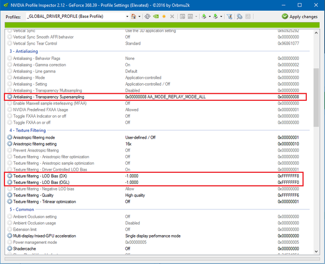

    Ja već izvjesno vrijeme prebacim tu opciju na "Clamp" u NVIDIA postavkama ali nakon što sam saznao sljedeće vidjet ću da ostavim na "Allow"
    Pretty recently, LOD bias has been automatically adjusted by the driver. You can override it though. You'll need NV Inspector.
    Open the profile editor, make sure "Texture filtering - Negative LOD bias" is set to "Allow"
    Set "Texture filtering - Driver Controlled LOD Bias" to "Off"
    Then adjust "Texture filtering - LOD Bias (DX)" to your liking. -3 being the sharpest (or blocky as you put it) and +3 being the dullest.
    Clamp looks the nicest normally because it allows AF to work it's magic better.
