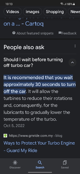

  13. SamiRX-8
    SamiRX-8 Komšija
    Pa nije problem ugasiti, nego treba ostaviti barem minutu-dvije da se ulje malo "ohladi" bar kada je riječ o turbo motorima. Mislim da je to Jaguar čak i navodio u user manualu za svoja vozila, ne mogu naći sliku.
    While turning off the engine immediately for naturally aspirated vehicles doesn’t cause problems, you will need to give a forced induction motor (turbocharged) a few minutes to cool down. This cool-down period won’t take too long as a couple of minutes is all that is needed. Since most turbocharged motors work on oil-fed bearings it is important that you don’t cut off the oil from this moving part immediately. This will ensure that the bearings will last longer and won’t suffer from any premature issues. It will also give the turbo some time to stop spinning thus helping prolong its life.
    To se odnosi više na turbo nego na atmosferce. Tipa ideš na auto banu u visokim obrtajajima i staneš na odmarališta i odmah ga ugasis. Ili uz neki prevoj i ugledaš kafanu da odmoris i opet ga samo uhasis. [​IMG]
  15. Stevie_Ray
    Sjecam se dobro, nakon auto puta, na granicnom prelazu mi start-stop nije radio. Motor se ne gasi jer turbo treba hladjenje.
